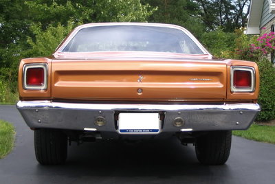

i currently run 275/60-15 on the back and have no problem with that fitting. if you are going to alter the wheels you have now bolt them up and measure to the springs and frame to make sure you have the room.
