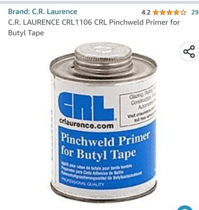

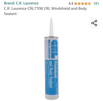

Related.
3M 08509 the go to for installation is unavailable.
I managed to find a NAPA with one still on the shelf.
Sumitt had 100 on back order as of a couple weeks ago.
I found this Mfg . Think they specialize in glass products.
Going to try their "flow able " butyl as an additon to my back glass install.
The 3M ribbon promoter says "paddle" sealant around the glass edge after installation.
Think this might be the thing to augment the ribbon seal.
I would not use silicone if this non setting product lives up to the advertising.
