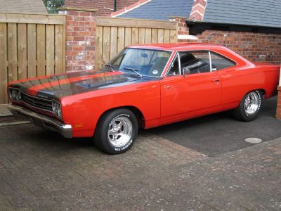

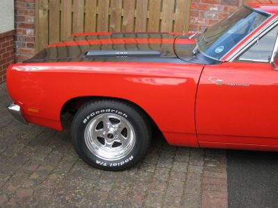

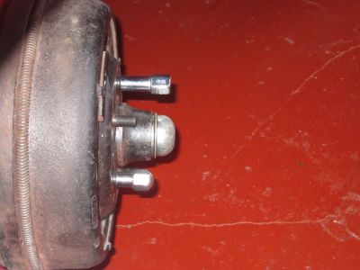

I've got my new Weld Prostars fitted on the car.Just a couple of concerns,the rims are a lot thicker than my Cragers,you can't see the studs when the wheel is mounted.I've done some measurements and I'm getting about 17mm of thread engagement on the stock studs with the long shank nuts supplied.Will I be ok with that ?
The wheels seem to be very secure,it just seems a lot of stress will be on the studs with them not running all the way through the wheel.
Is anyone else running or has run Welds on stock length studs ?

looks good Steve :drool:
I am rusty at this but I think I recall that if you can get a nut to grab at least the diameter of the bolt/stud you will have sufficient clamping power. Maybe someone else on the forum is more up or knowledgeable about this. If you have 17 mm of thread engagement that is 0.68 in. I don't recall the stud diameter but thought it might be 1/2 inch.
Can you install longer studs?

First off your wheels look great. Pro Stars are one of my all time favorites!! The studs will strip eventually and ruin the lug nut. I use nuts from Summit Racing that have a long reach that will engage the stud 1 inch. NHRA rules dictate the the nut needs to have contact with the stud equal to its diameter. Stock studs are 1/2 inch and you will need that much engagement to be legal to race. That roughly is 13mm IIRC.
http://www.summitracing.com/parts/WLD-601-1426/
These are the ones you need.
Thanks for the replies.I don't want to go with longer studs as they will be too long for the nuts for my Cragers(see pic) and I want to be able to switch and change when the mood takes me.I've got a set of the nuts that Chris recomends and also another set closed end so it looks like I'll be ok.
I just didn't want to do a burnout and the studs fail and wreck my rear quarters,so thought I'd check here first :thumbsup:

I like em! What size tire on the back? Mine are 275's and there's plenty of room.
275s same :thumbsup:
