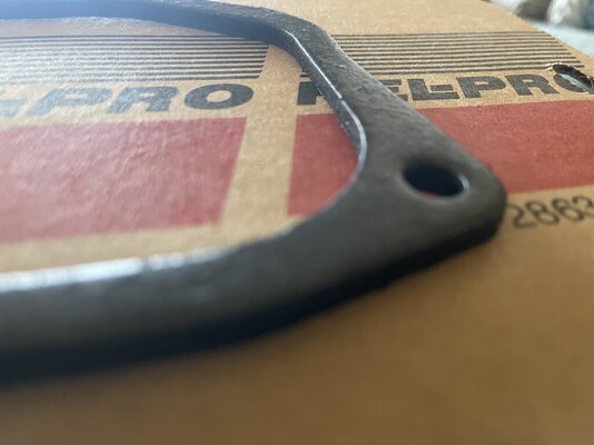

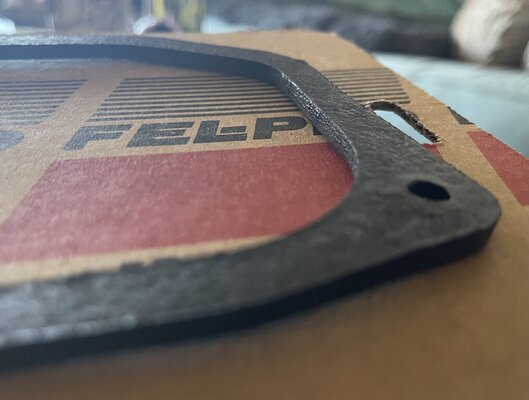

Sep 25, 2022 #1 Mike D Well-Known Member Joined Jan 21, 2021 Messages 45 Reaction score 36 What side sets on the head? The rounded edge side or the flat edge side of the valve cover gasket?
Oct 5, 2022 #2 MoparDan Well-Known Member Joined Mar 15, 2021 Messages 637 Reaction score 704 Location Stuarts Draft Virginia. The flat goes against the head. The rounded side should somewhat match the roll of the flange on the valve cover.
