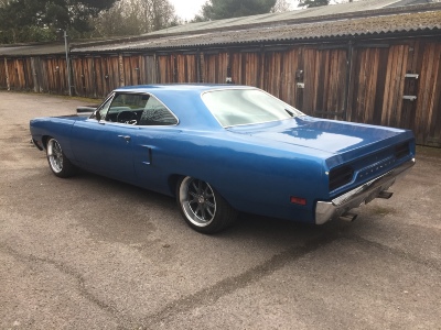

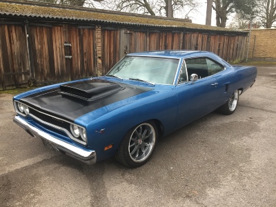

This is my current wheels, 18 x 9.5 with 265/40/18's on the rear, not sure on the backspace though, their website lists them as available in 6.75" , 5.75" or 5.25" so i'll have to take one off and check
With the current wheel off any idea what measurements I need to do in the arch to see if they will fit ? So just to clarify I want the 15 x 8 with 275/60/15 tyres and 3.75" backspace, I assume I should just measure from the hub to the wheel arch lip then find out the exact width of the tyre ? Thanks
Nice runner. It seams to me the tub tightens up quick. Found an 10 inch long paint stick will go in the width at the opening. But it shrinks down really quick. Wanted to put 10's on mine but will have to settle for 8's on the back.
I took a measurement and there seems to be 6.5" from the hub to the wheel arch lip
The current wheels on the rear are 18 x 9.5 with 5.75" backspace with 265/40/18 tyres
With the current tyre on there is about 1.5" between the edge of the tyre and the wheel arch
