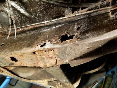

I'm considering a 1969 B5 blue bench seat auto with a matching numbers drivetrain, air grabber and 3.55 sure grip. Its also a manual brake/steering car so pretty bare bones. The paint looks great and the interior is very nice with new seat covers, headliner and carpet. The dash has a couple of cracks. The car starts/runs drives well in general and appears to be in good mechanical condition. The oil pressure gauge seems to read high at 75-80 psi. The trunk and rear quarters have been replaced and it appears to be a quality job, nothing visible from the exterior. I am concerned that there is a couple of quarter sized rust holes on the drivers side subframe directly next to the header collector. the rest of the undercarriage looks pretty good with much of it still covered in the original undercoating. The odometer reads 88,000 and the current owner of 20+ years believes it to be accurate. I've looked at NADA and Haggertys ratings and I would call the car a good #3(good) in general. I'm no expert by any means in this area and would appreciate any opinions on what the car is worth in the current market. Thanks in advance for your help!
I would stay away from it unless your going to take it apart and change the frame rails. I think some one fiber glassed over rust if I'm seeing it correctly.

Thanks for your response. I poked at that area pretty good until I had solid metal and I don't think there was any fiberglass. I will check it out more thoroughly to make sure. The rest of the rails all look good and solid. This is the one area that I thought might be a problem. Is patching/replacing that rail section prohibitively expensive or does it significantly hurt the value?

replacing that rail is a big job like diassembling the whole front sheetmetal, removing the engine, drilling spot welds out,welding,paint you can see where this is heading. And it would be safe to say that you will find more than one suprise during the repair like replacing the floor pans that the rail is welded to. unless it's dirt cheap I would use the advice above and pass on it.

Thanks for the input. Not really what I was hoping to hear but that's the info I need to make the right decision.

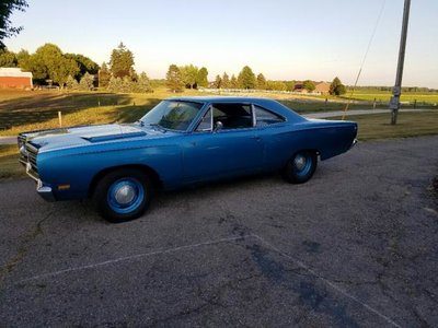

Also the quarters have the "quarter panel disease". If you look at the left rear quarter its too long behind the wheel oepning and sticking way too far out. Its typical of poor reproduction sheet metal and a novice install. Unless its real cheap I would run from it.

Yeah from that angle that wheel opening does look kinda wierd that is an expert eye right there I wouldn't have caught that so fast.

Thanks for the expert observations. The owner is very firm at $20,000. Sounds like I should pass at that price.
At that price some unknowing person will buy it. My concern is if he took that short cut what else is hiding.

At this point Im going to pass on the car at $20,000 per everyones advice. Im thinking its worth maybe $15,000 max and I know the owner will just feel insulted with an offer that low.
Thanks for the input, Id have never know about the issue with the quarters without it being pointed out here.
I'm thinking the quarters were patched not replaced. All the 69 replacements have the side marker holes punched in them already.
