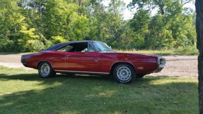

My 69 currently has 14” road wheels that are starting to look pretty rough. The closest replacement that I’m coming up with are the magnum 500’s. Not really a fan of the chrome on the 500’s that I’m finding but I suppose they will do. I was hoping to get a little wider tire on the back so I was thinking about going with the 15 x 8 on the rear and maybe the 15x7 on the front. My question is about the backspacing. The 15x7 are showing 4-1/4” and the 15x8 are showing 4-1/2”. Will this setup fit fine? Anyone running a similar setup? I’m new so I tried searching through the forum before posting but couldn’t find the answer I was looking for. Sorry if this has been discussed 100 times and I’m overlooking it.
Attached is a pic of the car with the current wheels which I love, just wish they were in better shape 289D05B6-39D4-462A-85EF-D448C5F12BFE.jpeg

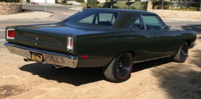

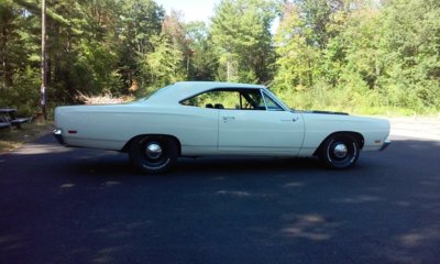

15x8 / 275/60/R15 Rear
15x7 / 235/60/R15 Front20180819_103404.jpg
7,854
3,430
Yes Ronliv. That is what I was thinking. Think 6 inch width would be too narrow but I do like that combo you have their. I will probably follow that lead. Due to the front tires do not distract from the back width. :thumbsup2:

Seems to be the common combination. I talked to a good number of RR owners before this decision and I like the way it makes the car sit. There is plenty of rear tire there, for me anyway, for those who want more than stock rubber and a little bit of hot rod look.

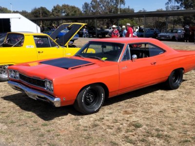

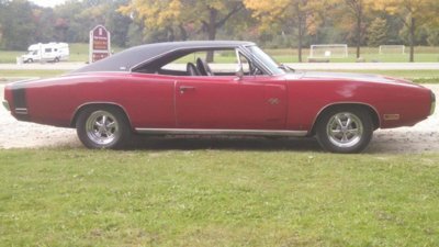

I run 295/50/15's with 15"X8" wheels on the rear with several sets of different types of wheels between my Chargers, Challenger and Road Runner. Here is a couple of them on the Chargers. I like a lower meatier look and not jacked up too high in the rear.

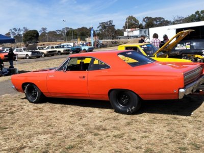

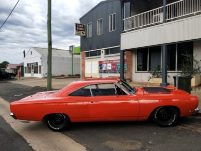

Hey Russ, just for you - I ran a set of 15x10' steelies over the weekend with some MT 28'' slicks - no rubbing. Except for that evil speed hump halfway down the return road, got me every time!
Wheel is from wheel vintiques, stock item, 15x10, 4 1/2" backspace. Could do with another 1/4 inch on the backspace (4 3/4" total)slicks1.jpg slicks2.jpg

I you look at what I did with the 2 and half inch recurve spring's think I might could get away with it. But need to finish the car and see where it sit's when fully loaded. I like it Russ. Thanks. :thumbsup2:
