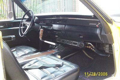

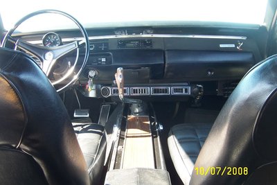

i started it way back in 96 before the easy add on kits of today , and I was anal and wanted it to look factory perfect . I still dont have working a/c in the car after all this . I wish i had waited for the easy kit . Changed the dash and all , but it needed a ralley dash installed anyway so A/C wasnt that big a deal .

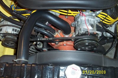

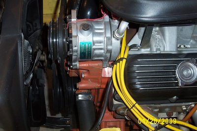

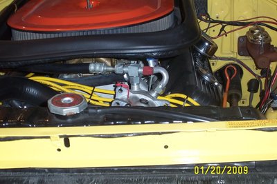

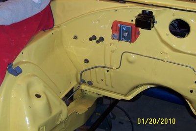

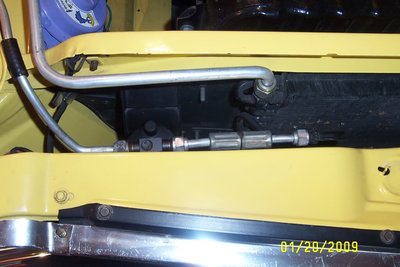

I added A/C to mine years ago also, before the kits. The condensor is from a 1967 Coronet Station Wagon I found in a JY. No new holes were drilled in the firewall for the installation. I also added a 26" radiator. The A/C unit itself is from a truck A/C company here in Houston. They outfit 18 wheelers, street rods etc... The holes in the lower left of the firewall are for the high and low hoses. I bought a kit from Bouchillon years ago for mounting the compressor where the Power Steering pump would be but I discovered that it would not work with Edelbrock heads. The heads overhang the block by about an inch therby interfering with the compressor. Fortunately the compressor fits over the boss for the power steering pump. A spacer is needed for alignment.
