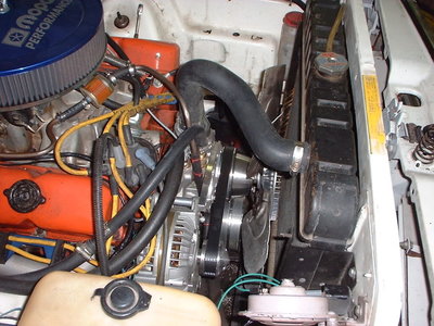

Here is a shot of the pulleys. Straight as a gun barrel. I know I had the bolts in tight. Some high RPM vibration must have shook them out. Could the alt not be gong along with the program at 5K or so? I really don't think the belt was all that loose. Maybe it got hard to turn at that speed?

the buzzing behind the dash is the speedo cable. my Uncle had parked my truck for 5 years before I got it last year. cold or warm weather the cable would buzz for the first few miles, even after I oiled it. after a few months of everydy driving it quite.
my '68 Charger thet I had for 18 years had a vibration around 65. not bad, but enough to notice. under or over 65 it went away. was like that the hole time I had it.figured the driveshaft was out of balance. I had several sets of wheels and tires, and had replaced the wheels bearings, and it still had it.
