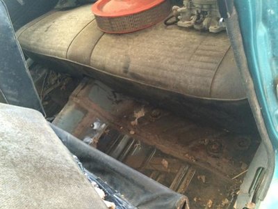

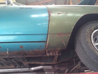

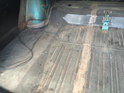

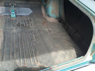

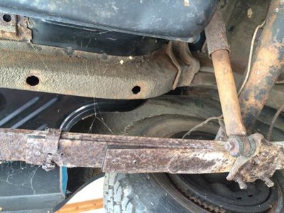

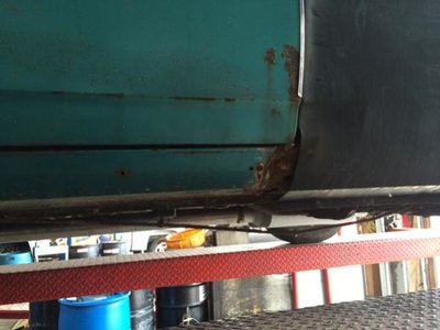

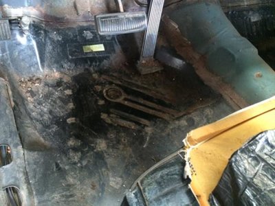

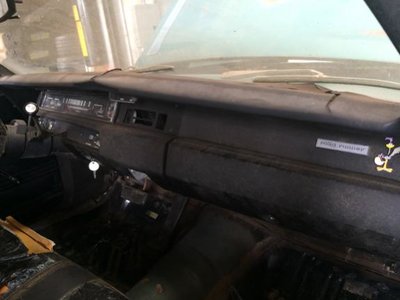

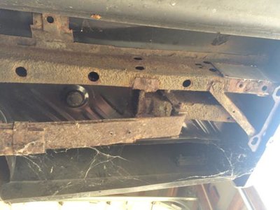

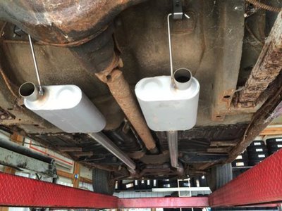

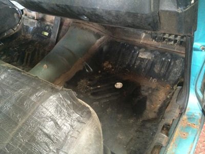

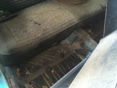

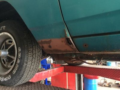

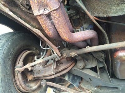

So I am looking at the following car as a project car to restore with my son. It is the same color my dad painted his 1966 Satellite that he had to sell when he got cancer and I was unable to buy back. As amazing as I think it would be to have my dream car in the same color, which I love by the way, I don't want that to cloud my judgement and could really use you guys help. I would like some input on what you think this car is worth and if it would be worth making an offer on. It does run, but needs a full restoration. Floor pans, trunk pan has been replace, and rear fenders have been replaced. That's about it. Your help is greatly appreciated!
Here are the photos:
https://drive.google.com/open?id=0B9tRu_7FwsT8QWJUeTNpMmpSUmc

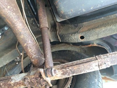

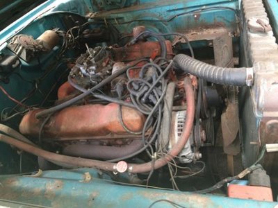

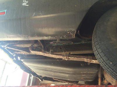

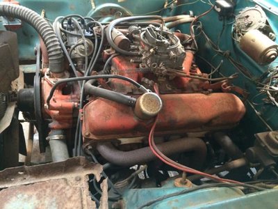

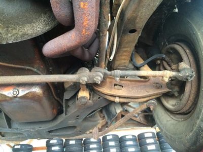

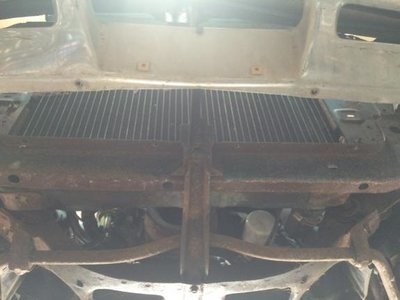

Nothing matches on this car. Needs front quarter work, doors, as well as sill plates. Frame rails need cleaned and have been repaired which implies more rust. Needs new wiring harness, engine looks iffy, will need work. I personally would probably not go over 8k and would be reluctant to go that.

your gonna end up sticking over 15,000 in body, wiring, interior and engine alone, besides what you pay for it. if your not handy it's gonna cost u more money in the long run. I'd find one in better shape that you can drive. Wait till fall when people don't feel like paying for storage over winter. Not sure what u want to spend.

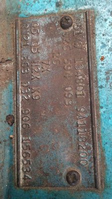

Also, I have tried to decode some tags as I have been searching, and it looks like the tags are stamped different depending on the plant they came out of? Is that correct? Based on this fender tag, it looks like it only tells you the color, engine and tranny. Is that correct, or was this RR so basic it had absolutely no options, or did this plant not include that information on the tag and it would have been on the build sheet?

Before i read any replies the number in my head was no more than 7k . The rust in the rear sub-frame rails is most likely more significant than the pics indicate. I would have to look closely at the caliber / quality of the replacement metal work (quarters, floor pans) as this may need to be redone to be safe and correct. If you quantify what you are starting with there will be fewer surprises along the way. From the pictures even with issues it is a start for the right price. Chris

fender tag will tel you a lot of info. will have codes for paint, interior colors as well as options such as stripes, also some interior packages etc. there are some great books out there with all these codes in them so you can decode that fender tag.
There is not much on the tag it most likely is from the Lynch rd plant. Seafoam green top and bottom black high end bench interior with black painted doors, 383 HP

Thanks guys! I spoke with my uncle and he pretty much said the same thing. I think he used the term "bag of shit" and for me not to be offended, which I am in no way. I don't want to get into a money pit. He said that it could be restored, but at that point I am better off finding a more solid car to start with. I am learning. Looking at the pictures and getting his input is helping me identify the areas to look at, and what I am actually looking at. I really appreciate you guys on here helping out. I know the right one will pop up and in the mean time, I will keep searching and learning.
