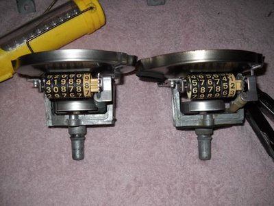

I've read about this happening. The odometer is interchangeable between car models except for one key feature...
Chances are that someone switched out the odometer to show lower miles (like taking your car through the Peabody's wayback machine)
Here's a pic I snagged off the web... See if you can spot the difference. I'm told one is used when the odometer is above the speedometer center and one is for below the speedometer center.

Brackets (no idea what those are called) by the gears seem to be mounted at different heights allowing for a different pinion gear...?

Looks to me that on the right unit the input shaft is off center to the left, while the other one is off center to the right. So assuming the input shaft rotates in the same direction on each one then each unit would rotate in different directions depending on which side it is off center.

Kind of goofy, Did this work right 35 years ago? If the speedo is working then the cable is going the right direction. Then problem has to be in the speedo head. In the above pics, they both will be the same as then numbers are backwards on the rollers....
