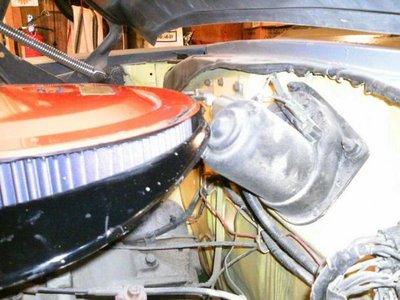

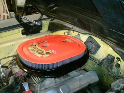

put a Coyote Duster on your car without a three speed wiper motor.

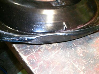

I bought this air cleaner because it already had a dent in the wiper area(made it cheaper too)

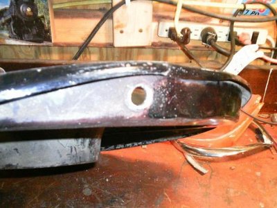

The base wasn't hitting the motor, but the breather tube was. Since the base already had a field modification, and my Direct Connection valve covers didn't have a breater tube, I cut the tube off the base. still need to weld up the hole.
