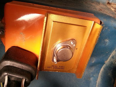

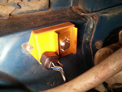

Hey monk,

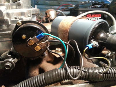

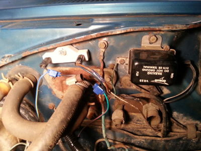

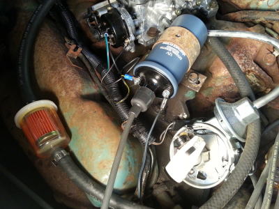

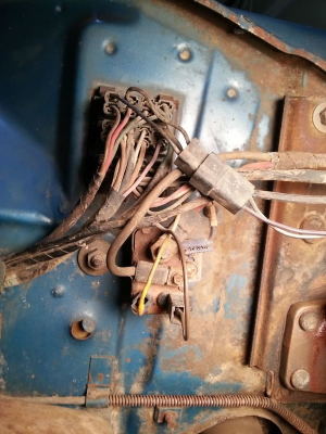

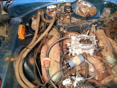

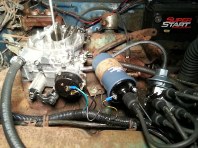

Its an automatic. Right now I've just been trying to get this thing running good. Then moving onto bodywork and cosmetics. I haven't had time to change out the ground wires. They need to be changed. Here are some pics of what it currently setup...

I don't know it there is any thing to this, but I have been told that the wire connectors need to be on the bottom so they are covered with the oil inside of the coil. When you put on the new coil try to turn them to the downward position.

Thanks for the great Pics W8ker! Something else jumped out at me! The 69 and before cars had an internally grounded alternator that had only one brush. They could be converted to the 70 and up style 2 terminal deal but also would require the new style regulator. It appears you still have the old style... with the electronic ignition conversion. This I am told, is a big no-no! The electronic ignition required a much more stable voltage for it to be consistant and not the old heat up and cool style regulator which your pic shows. I got mine when I put it together in the late 80's. Losing the points gained me 2-3 miles a gallon and the ability for it to run in the rain which it would not do until the engine got heat soaked. They are supposedly still available but I honestly have not seen them for awhile. I will snap a shot of it tonite and try and post what your looking for. Anyone else have anything on this? That may be something to look for too, but the other ideas are great places to start (no pun intended) too! Keep the info rolling!

I'm trying to understand your response. So what you are saying is that I have the older style internally grounded alternator with a newer style regulator and this is a big no no? Or do I have an old style ballast resistor? Or an old style voltage regulator?
Just a bit confused on which of the above three you are referring to.
Obviously I'm having some kind of problem with the regulator as my coil gets super hot....almost to the point of burning your skin. I had a friend install the electronic ignition setup.
So I guess my question is...should I just buy a whole different voltage regulator? Ballast Resistor? Coil? All three?

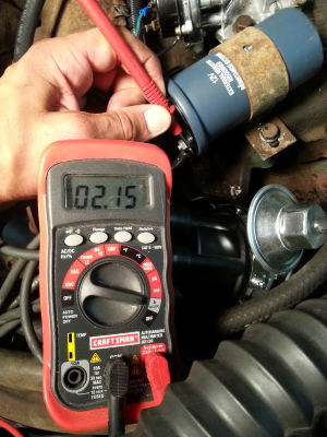

If I check the DC voltage at the positive side of the coil with the ignition switch turned "on", I get a reading of around 2. Shouldn't this be closer to 6? I checked to make sure the coil was not wired up backwards. Everything seems to be wired correctly. Sorry as I'm a newb to a lot of this electrical stuff. I'm not even sure if I'm reading it correctly!

Good evening W8ker! I hope your not getting to frustrated. Keep plugging away and you will get it. I know when I added the electronic ignition kit, it said I must have the new and updated solid state voltage regulator as it is much more stable. It provides a constant 13.8 with the motor running instead of the old style which was basically a resistor that heated and cooled varing the load on the field of the alternator to tell it to charge lightly, average, or heavy depending on voltage of the battery. The one brush deal is on the alternator which is the other end of the wire that hooks to the regulator. (70 and up have 2 field terminals on the alt while 69 and before only have one. Do not count the heavy wire that transfers current directly back to the battery). Now that you mention it, I almost think the ballast resistor had been changed when the kit was added. I will have to dig deep to find the paperwork on the electronic ignition kit to confirm that, however. I quickly checked ebay for an electronic regulator for the old style and they now have a old look but eletronic style. Neat! I have had the blue style for a long time with no problems but it just doesn't look very retro.

As you, I am still a bit confused. After it runs and warms up a bit, does it not start, or does it not crank? Those are totally different issues to solve. Let us all know! It does look as though your wiring on the starter relay is correct. Double check the yellow wire. It is not melted is it?

And another post now that I have looked closer at your pictures. I noticed you have an engine ground strap. (the 8-10 gauge wire that runs from the fire wall to the rear of the right cyl. head) Make sure the connection to the firewall is good. This is the ground that the body (and ignition switch) share with the engine. The motor is grounded well through the big wire from the negitive of the battery but being isolated by the rubber mounts of the engine and tranny doesn't do much for passing electricity (current). Also, when you were making your voltage mesurement with the voltmeter, it appears you were in current measurement mode. Your voltmeter should be in VDC position to measure the voltage at the coil. Think of voltage as the amount of water above the dam. Think of current as the amount of water flowing over the dam. And resistance, (IE the loads of the coil, ignition, lights, horn,etc.) as the size of the dam. Try your measurement again. Ask more if still confused.
