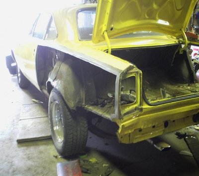

that's called paint......:jester: all that remains of this....my body guy hasn't done under the hood yet.IMAG0026.jpg
301
now you tell me after 95% of the yellow is gone!!!
