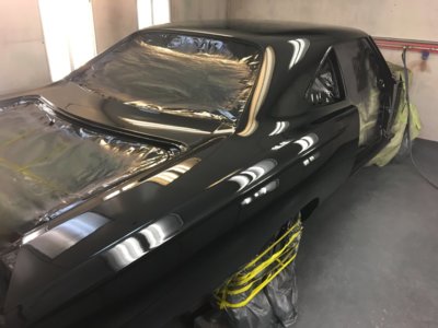

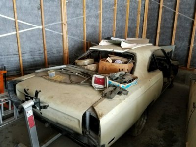

First picture is how I found it, completely dissasembled and a unorganized mess. I have known and seen the car for many years so looking forward to bringing the bird back to life once again. Bottom picture was just last week. The car is now lowered, disc brakes on all for corners, power steering and will have a the original 383 completely rebuilt (which is already done). Lot more work to do but getting closer

She looks really good. How far along are you with the car. Trying to get the shell painted on the one I have.
Putting everything back together now. I am concentrating on interior parts and pieces now.
