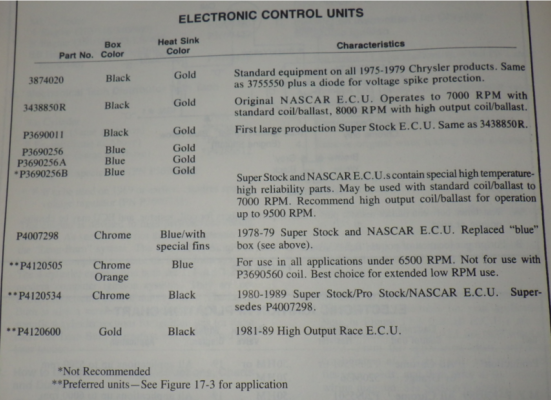

I read that the different color boxes are for different RPM range. Like the blue and silver is that right.

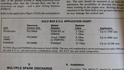

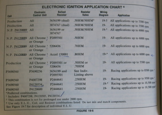

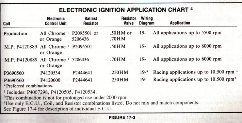

Yes there are a bunch of different ECU's. I have some allso if needed NORS or NOS. These charts are for Mopar OEM, aftermarket boxes they do not appy to.
I have not been on here in a while. I have been testing the actual RPM that the boxes I have come across run on my mock up. Tell you what having the right balllast resistor makes a big difference.
back in the day it was black 5000 rev limit orange was 5500 rev limit chrome was 6500 and gold was 9000 if i remember right
