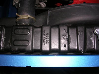

Mine is a November '68 build. Here's a pic. Never really understood the font size deal on these, maybe Ray knows? You can also call Glen-Ray, they even repop them with MOPAR license.

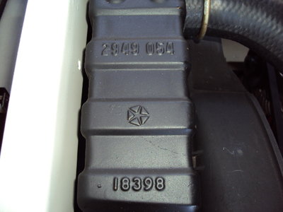

Chris there is some discussion of large font small font as far as A12s and I don't know, this is my original. You might check the lift off hood sight for more input. They were as high as $1500 during the top of the market and before the repops.

Chris, the consensus is small font (like the one Bob has pictured) is correct for an A12.
Like all things MoPar, never say never (even though I did the other day regarding 383s in a GTX... :lol: ), but it seems that they all came w/ small font 054s.
