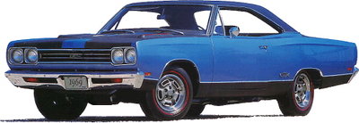

Hello,
my Runner got the org. 14" rims on, but on the built sheals is written that the Runner was ordered with 15" rims, but the owner didnt know anything about other rims,
he said that he alway had the 14" rims and he know the car since the first day.
Was it a possibility to order 15" rims instead of the normal 14" rims, or was it just a typing error?
If yes has someone a pictures of them, or can someone offer my 4 org. 15" rims?)

15" X 6" steel wheels came standard on the Hemi & A12-equipped cars...not sure if you could special order them on a 383 car or not...? I even looked in the reference section and couldn't find an answer to this question...maybe I just missed it...

The standard size wheel on a '69 383 Road Runner was 14x5.5....Could you post a copy of the build sheet? It would be interesting to see. I'm with Ray, not sure if 15" rims could have been special ordered or not. My initial thought is no....

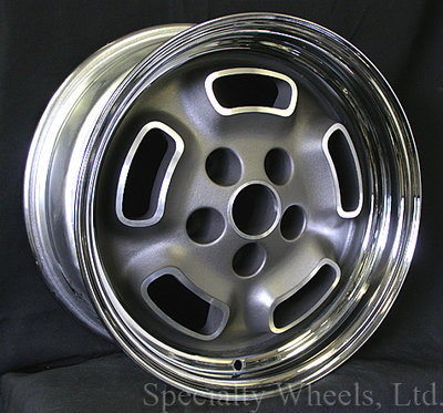

the build sheet should have it on there , it would have to have been ordered and build before august or sept of 68 if I remember correctly . They were only availible a very short time before being recalled for the centers tearing out of them .

Ok, thanks to A31PKG. It is a exactly what I am looking for!!!
The 15x7" Older Style *(shot-blasted bare steel) looks more less like the org. 69 rr rims, just bigger!
I will take two of them with 245 or 255 for the rear end, in front I will leave the org. 14" with 205.
