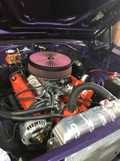

Grate looking power plant and the engine bay looks good also. See you take care of your baby. Yes the auto part's stores just push parts and type on the computer. Take your money and say see you latter. Have had problem's with cheap coils on several application's in the past. Even ones mounted vertical quit working. Cheap junk. Hope you got it figured out now. No we get frustrated when thing's where working then out of the blue it goes south.

Replaced the box. One I had was the blue box and I installed a Orange one. Runs good now. I guess I need to order another box to put back. I would almost switch over to a MSD 6AL and there would be no problem in the future (i actually have one from old race car in the shop). I just hate it changing the look from being stock under the hood.
