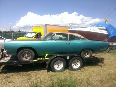

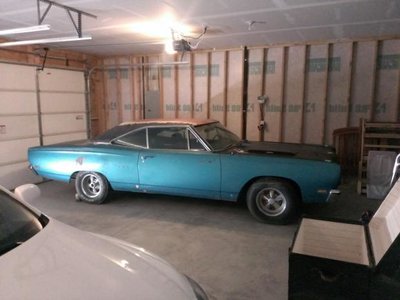

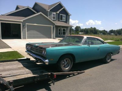

My project is a 1969 Roadrunner with a 383. It's an automatic with front bench seats. The original color is the Seafoam Q5. The car sat in outside storage for more than a decade. This was my father's car and I inherited it after his death. My wife and I built a house this year (Summer 2013) and I finally have some space for it and have started working on it slowly as I learn.
I am new to cars as a whole. I unfortunately know close to nothing. But, have a lot of resources at my disposal. Hoping you guys can help as well.
I know this is a huge challenge. But, one that I'm pretty excited for.
If you guys have any suggestions on where to start, let me know. I'm open for any and ALL suggestions.
agreed. what kind of shape is the car mechanically? Does the engine run? If so, I'd go thru the brakes,replace the hard and rubber lines, master and wheel cylinders. Since it's been sitting, probably need to check the gas tank for rust inside, and replace the fuel line. Give the car a tune up, and enjoy it for a while, and save $$ for the resto. one thing that kills projects faster than anything is tearing the car apart and getting overwhelmed.Next thing you know the car has been apart for 20 years. Judging by how good the body looks after sitting outside for 10 years, I'm guessing your not back east in the rust belt.I'd make a list of what the car needs, what you want to do with it, then check on parts and prices. These cars casn get pricey, but to an extent only as pricey as you want, and you don't have to do the whole car at once. that's one reason I say drive and enjoy the car for a while.

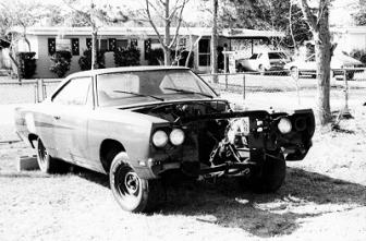

You could have bought your runner in this condition and wanted to restore it like I did!!
Freebird.jpgI think I can top that one. had fun while it lasted RIP
