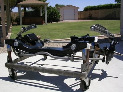

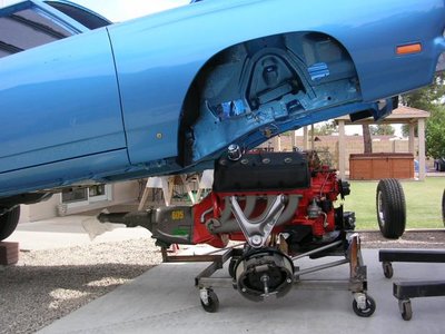

Any one remove the K-Member from there RR and how much of a job is it ??
Tom C.
22,148
2,358
If your engine and trans are still in place. You can build or buy a cart, disconnect all the hoses and wires pull the drive shaft disconnect the steering coupler pull the torsion bars the upper control arms remove the 4 k frame bolts and lift the body .. Here is a pic of mine going in

22,148
2,358
Remember to remove the bump stops on the frame under the upper control arms so they sag all the way down when you lift the car. And loosen the torsion bar adjusting bolts.
