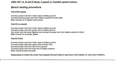

I know this may be a dumb question but I have 2 different 3 speed wiper motors out here. I grounded one with my jump box and then stuck a short jumper wire in the positive side. When I touch the jumper wire to the outside wires in the plug I get two speeds. When I touch the other wires in the plug I get nothing. Are these 3 speed including stop? (Slow, Fast and Stop) I also tried a 2 speed motor and get 2 speeds. Just like some input if you guys have tried this on the bench. :cool:

I see! I should have known that I guess. Its been a while since I have played these games! lol :yesnod:
