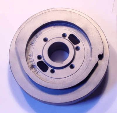

This is one for a 400, but it's representative of all your externally balanced cast cranks.

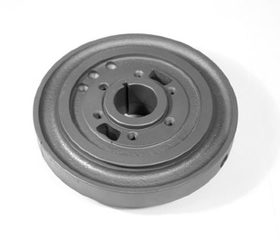

Here's one for a internally balanced, forged crank.
I'm still not 100% believing they made a cast crank 383.... But there ya go.. That's how to tell.
