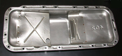

Are there any issues, like the oil strainer, dipstick, etc. if I replace my banged up 402 pan with a 971 that is in nice shape? The Engine in the car has a casting of 2468130-9 LL . I have the numbers matching one on a stand in the shed, it needs rebuilding. I have been following Gary's 383 project closely. I think I'll make a book out of it. Every time I ask a question now, I feel like a bell should ring. (round two)..........Thanks, Jim
A12
Jul 16, 2009
472
A12
Jul 16, 2009
472
BTW; That's a photo of the new "repo" 402 oil pan and Bill Allphin of A+M Hightech Automotive is offering a group buy price over on the A12 Registry site if you or anyone is interested.....sorry if I shouldn't have said that....

I'd use it if I were you - it's a five quart pan versus the four quart 402 pan. Do you have the strainer that came with this pan? - as pick-up/strainer number 3614224 is called for with this pan.

No I do no have the strainer. So that is what I needed to know. I think I can use the same dipstick because the pan area is a little longer, not deeper. Also there doesn't seem to be any issues with the centerlink............. thanks........Jim
301
I couldn't tell you whay pan mine has, but it takes 8 quarts, but has stock depth, so you're pickup and dipstick should be OK.
