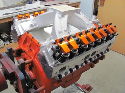

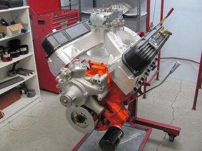

We ran it with Edelbrock Performer RPM and Edelbrock Victor intakes, but spent most of the time with the 6-BBL because that is what the owner is running.

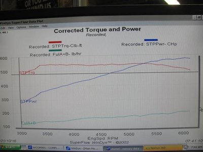

It's a pump gas 9.9:1 compression .030" over 440 with a stock forged crank, a custom solid roller that is equal to a 232/236 @ .050 hydraulic roller and as mentioned, using the new 240 CNC Trick Flow heads.
With the 6-BBL it made 560 LB-FT of torque and 590HP.
I've added a couple of pictures of the engine and one of the torque and horsepower curves this engine produces.

Wow very impressive numbers, for basically a stock 440.
sounds like you have a very balanced combo! cam, heads, carbs all working together to give the motor just what it needs!
What timing are you running?

The new Trick Flow heads are working pretty good and are a big part of the reason we are getting another 200 horsepower more than a stock 440 6-BBL. We are still staying in the 38 degrees total range. The engine is just a cam and intake change away from another 100-120 horsepower.
