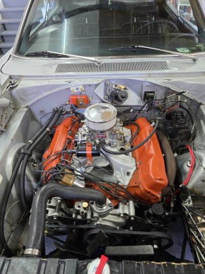

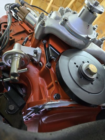

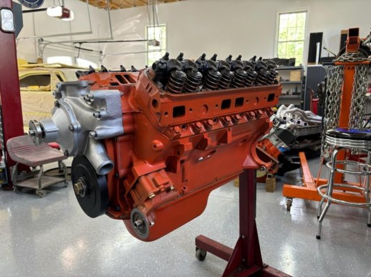

Friend of mine Cliff Lowrance has built this +.030 for my roadrunner! Can't wait to get her in the car. Getting close.

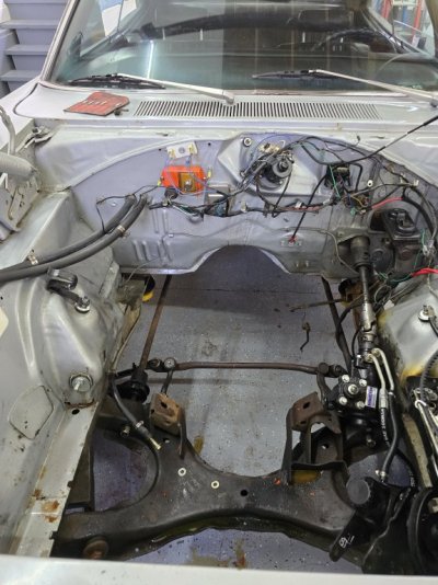

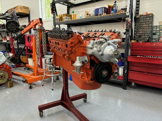

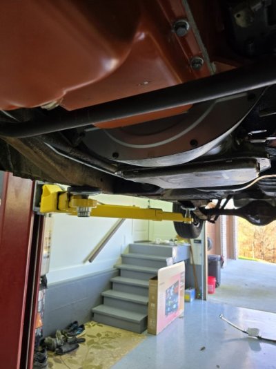

Well pulled out the motor and transmission.

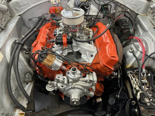

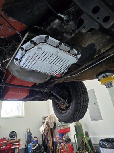

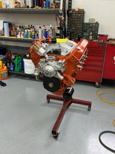

My friend Cliff Lowrance built this one, 440 and stuck it today. He is rebuilding the transmission. Bought a new B&M 10 in 2500 stall converter

Oh yea it makes it alot easier. I spent many years on my back on a concrete floor. To old for that anymore.

Installed new 489 3.23 sure grip rear center section. Little more than 3.55 but will give torgue along with highway travel.

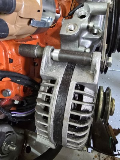

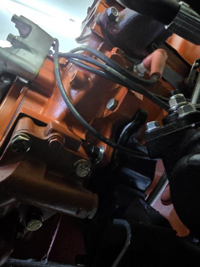

Installing new leaf springs and getting new exhaust. I have completed wiring in the car. I can't get the oil light to come on. I'm gonna have to pull the dash and I believe the circuit board is bad.

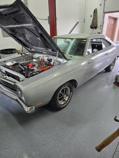

Gotta get the right air cleaner on but did get the exhaust on but they are wrong. I ordered them as the oval and they came round. Aggravating but it would be another month before I could get the exhaust installed.

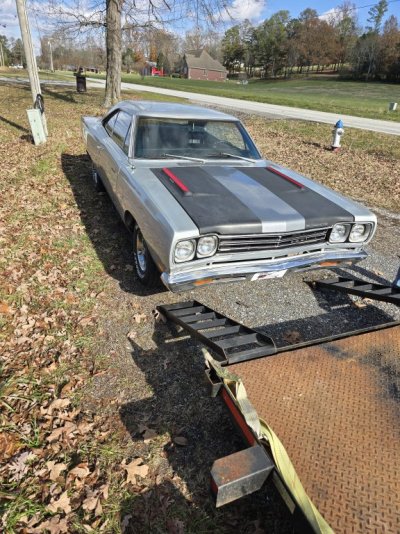

Loading her up. I will post a exhaust pic later. I have a video but too large to post.
