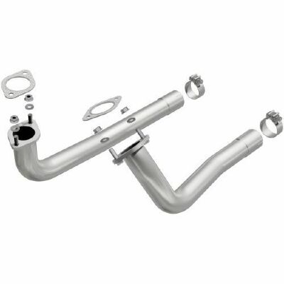

This is the Magnaflow 19304 Exhaust Pipe 2.5 ". According to their spec sheet, it's good for the BB and RB. The rest of the system should not be a problem. I would of thought that this would be slightly different for each application.
