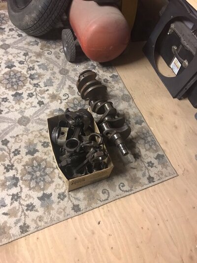

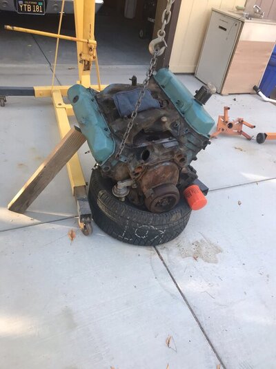

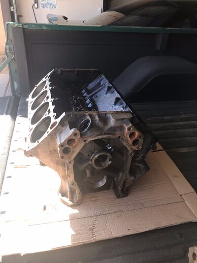

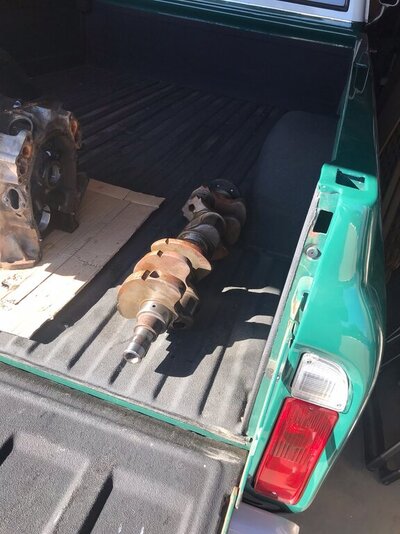

Well I picked it up yesterday. It's a 76 with low miles and also came with an extra steel crank and a set of LY rods. Going to get it on my stand and tear into it a bit today. I would have to tear it apart to have the crank snout machined for a 4 speed. That's why he threw in the steel crank. Lets hope it all pans out. 440.jpegLY.jpeg

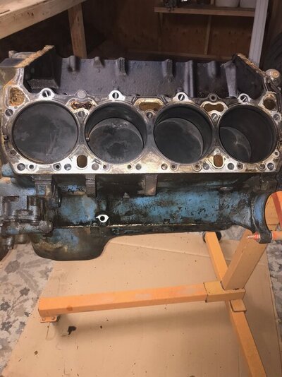

I have a 383 now. It runs good but not that good. A buddy put a motor home 440 in a Sport Satellite and it gets up and goes. I understand I will have to use a few parts from my 383 like the pan, pick up, windage tray, motor mounts and I think my timing cover. The crank is not drilled for a 4 speed so I have to change it and the damper also. Took the top half off yesterday and this engine has flat tops. I will need a cam and pistons so this will be a rebuild not just a drop in. Guess it's true, there's no replacement for displacement.

Hey terry did you micrometer your cylinders before you took it in. Bought gauge off line to do mine. Won't use it much and can under stand if you did not invest the money for one. Hope you have enough meat left so you don't have to sleve it. Keep us up on the progress buddy. :thumbsup2:

It's an RV motor that had low miles. Should be able to get away with a 30 over stock. My machinist said it looked great but had a little lip and would probably need bored. He said it's common because the RV pistons are so far in the hole. Will let you know.

Sound's good Terry. Yes the crust ring at the top is normal. Good to here the taper in the cylinder is not bad. 30 over is still a good driver motor. Got lucky and found a block for my car that only had to go 20 over and made my day. Good luck with the build and know your excited to say the least. Russ.

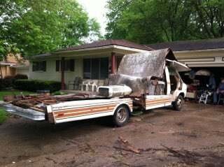

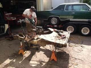

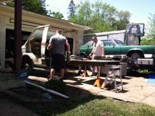

Bad thing around here with the last one I called around to 36 different junk yards, scrap metal places and recycling centers. No on one would take a motorhome even after I stripped out all of the wood from inside. I wound up cutting the whole thing into a million pcs....
