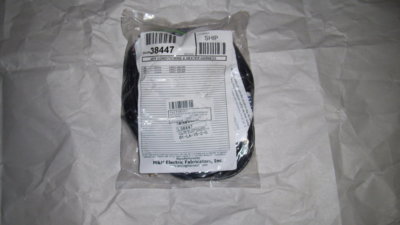

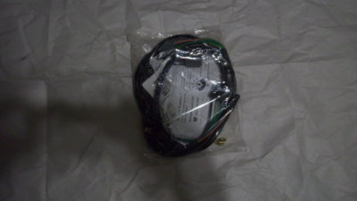

If interested, I have a new, still sealed in the package, 1968-1970 B Body AC/Heater wiring harness.
(Classic Industries #MB1811) I will ship it to you, $20.
