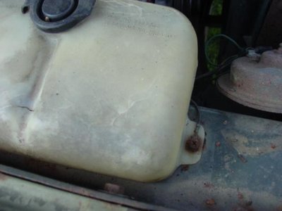

My '68 had it on the passenger's side and I have photos of lots of original '68 St. Louis and Lynch Road assembly plant B-bodies with them on the passenger's side. IMO it's the most incorrectly placed label on a '68 B-body when it is on the driver's side.
You can see the outline of where it was on a '68 road runner in front of the windshield washer fluid container

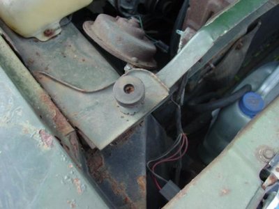

And here is the smaller fender mount and hood bumper pad on the '68 models that made it easier to place it there on the same '68 road runner

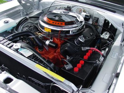

This one is a top placing National winning '68 Hemi road runner of a good friend of mine (he has a heater box I gave him in it that he never paid me for if you're reading this Rick LOL) that the emission label is in the INCORRECT LOCATION, showing that the judges don't even know the correct location.

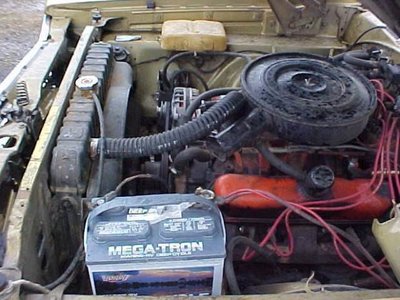

Also that image from the '69 sales info of the '69 road runner vert showing the label in front of the washer fluid bottle has the smaller '68 hood bumper plate so it was keyed off of the '68 placement when they prepped that '69 rr vert for the sales info in August of '68.
I own that car now, and have been driving it. It's had a few issues.
