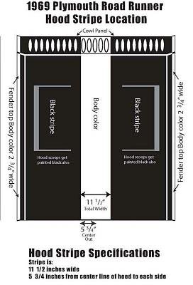

I wish to paint it the original color but was also thinking about adding the wide black stripes across the hood. I am new to Mopars so I was wondering if these stripes were significant in some way? Also, weren't they flat black with no sheen?
The reason I ask if that if I decide to go with them and they are flat black, then I just assume that I would just have to tape them off and shoot single stage with a flattener, as clear coat would have gloss. Do they make decals for these stripes or a stencil kit for that matter? I'm also going to need a new vinyl top and head liner.

The original hood stripes painted with flat "Organisol". Not sure it it is available anymore, but someone better informed will chime in soon.
There are no decals for these stripes that I am aware of, nr have I ever seen a stencil kit.
Year one, Legendary Interiors or Classic Industries should have the headliner. Not sure about the vinyl top. I'm sure others will have more options.
Here's the dimensions you need.
http://www.roadrunnersite.com/images/roadrunnerhoodstripes.pdf

Welcome. The black stripes on the hood are called the performance hood treatment (V21) and they are painted on. They were organisol (flat textured) black originally. A lot of guys put gloss black due to that taking a lot less upkeep. Personal choice as to flat or gloss, but to be correct, they should be flat black. Here is the lay out for them.

Thanks for the info guys. Huge help. I guess I'll try a single stage black with a flattener for the stripes. Thanks again.
