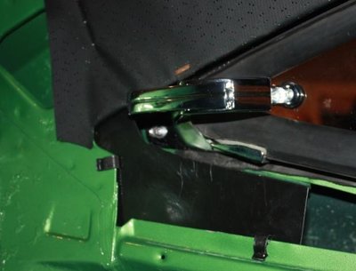

Hi its me again, also need pics on the rear pop out window. I believe their is a bracket that holds it in place but I cannot find in the manual how it goes in place. Can someone please provide me pics on putting the rear pop out windows back in place. My hair is falling out and turning gray, thanks again for all your help.

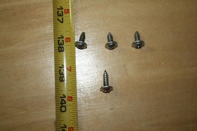

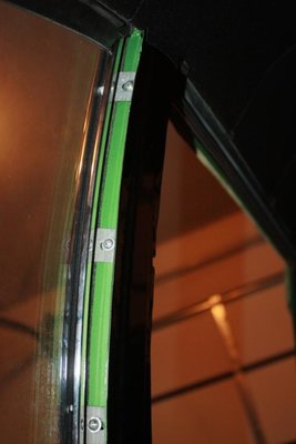

Here you go. The front of the frame is held in place by 3 screws to the post. These tabs are welded to the frame and sometimes break off. The back of the frame is held in by a single screw, it is longer than the front ones.
The hasps that lock the window in place are available. The reproductions are very nice, but I could not find them again with an Ebay search???
Hope this helps.

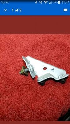

Hey Big D thanks for the pics, my biggest issue is how the back of it bolts in, I was told this bracket attaches to the pop out window, they are marked left and right, just not sure where and how this bracket is put in place or where the dang thing goes.

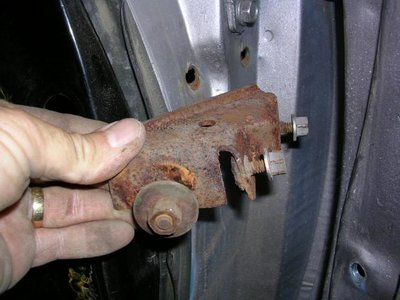

That piece is for the door vent window, not the rear vent windows. It bolts inside of the front door. The one longer screw holds the back of the rear vent window in place.
I am holding that piece the same way it goes in the door. See the two holes in the door behind my hand.
