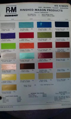

Thanks
This 1970 Plymouth RM color chart is the source of my confusion (I think I attached it) indicating that V2 was "* also a spring 69 color", although it's correctly named tor-red, which I don't believe was available until 1970 for Plymouth (EV2) (always wondered why they added the "E" to 70 color codes ? )
I haven't got a good pic of the 1969 RM Plymouth color chart, but it has only the early year colors (no spring colors)
I think the time of printing must have been a factor, because the ppg charts seem to be consistent with the spring 69 offerings of K2 for plymouth only and V2 for dodge only

I have read, i've not actually been around a dealership back in the day but....
if Chrysler had the colour you could probably get it on your Plymouth.
just my 02

I tend to think that's correct, but I'm wondering if a 69 Plymouth was painted in tor-red/hemi orange then maybe it would be code 99 rather than V2 ?
