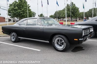

    Hey Guy's what is the largest tire that I can fit under my car on the rear. I measured the inside of the finder well and can't get a 12 inch wooden ruler to fit so thinking that all I will be able to put in their is 10 inch width tire. Also do I need an off set rim and how much. Thought about putting mini tub's in but that is a lot of work. Also have to move a lot of thing's so I don't think that is worth it. To raise the car for 28 inch tall tire we use to put the springs on top of the rear end. So any Idea's would help want to make the car look bad. Thank you for all your help you guy's have a lot of information. I have forgotten a lot and looking for some one who is doing the same thing. See Ya.

    10 inch is usually the max for a normal wheel. 4.5 in backspace

    I have Mickey Thompson Drag Radials on my 69 RR
    295/65R15 on 8" wide rims with 4 1/2" back spacing
    30.1" tall
    11.8" wide

  8. 1baddogg
    1baddogg Well-Known Member
    Messages:
    46
    Likes Received:
    Joined:
    Feb 17, 2016
    Location:
    Jasper , Alabama
    13419136_10209142516347451_3431388188077714263_n.jpg 10s fit good
    Peanut gallery likes this.
