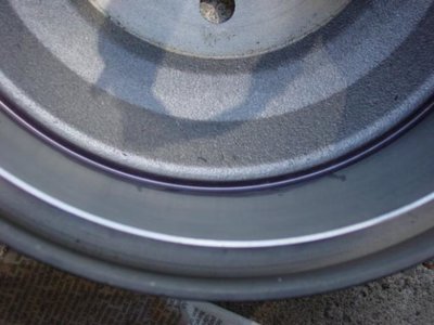

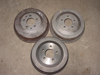

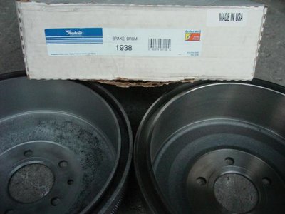

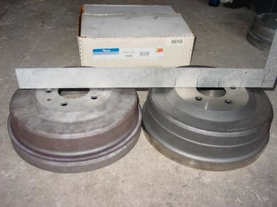

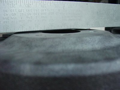

Here are some photos from the time I was having similar issues with the front brakes on my '68 road runner......just random but it may give you things to investigate.DSC02539.jpg
considerable difference in the same 11" drums spec'd for the car and the original
I think after everything I had to add a thin shim at the arrows to move the drum outward so I could run the correct wheel bearing tension then the brakes worked great and never pulled. This was a few years ago (maybe 2003 or 2004) so I'm not clear at this point but if you try a few things with the wheel bearing tension maybe some of it will come back to me?View attachment 8958
