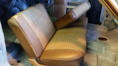

Most of the 69 Roadrunners that I have seen have headrests, even on the bench seats. I picked up the rest of my parts today including the front seat. Interior in this car is the Saddle/Bronze "Decor" interior that comes standard on hard tops...but no headrests. Based on the condition of the seats and the history of the car, I'm certain (not guaranteed, but certain) that these are the original seat covers. Should it have headrests? Is this an "early" car that didn't get them?

Mine does not have head rests. 1969 with build date of Dec 1968. Also has the black door buttons that was a 68 feature. Some of the early cars used remaining 68 inventories.
Federal laws mandated head rests on cars built after 1 Jan 1969. Before that head rests were optional.
