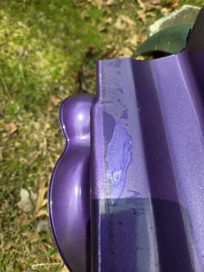

Tamco is sending me another 4oz sample to try for FREE! I don`t have a lot of hope it will be any better but we`ll see.

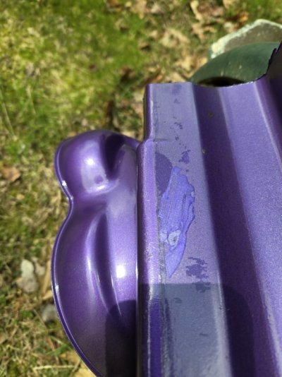

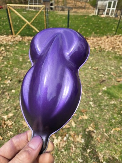

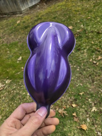

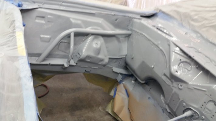

I`m getting close to painting the underside so decided to do a spray out of my Tamco FC7 sample, I am not happy at all with the color match. Center strip is Tamco and outers are factory original.
Ya , it's kinda light. Or is the old paint contaminated? Have you tried a little buffing compound on the old paint?
torredcuda
Oct 23, 2022
423
490
New Hampshire
It`s the underside of a trunk lid so very little exposure to the sun and elements but I did buff it up first.

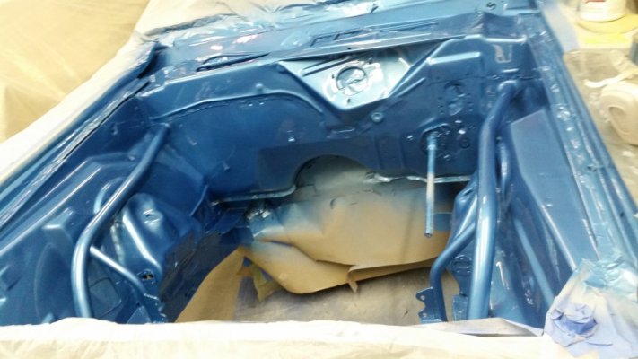

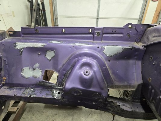

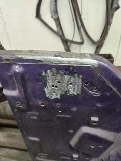

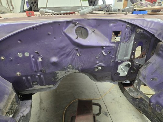

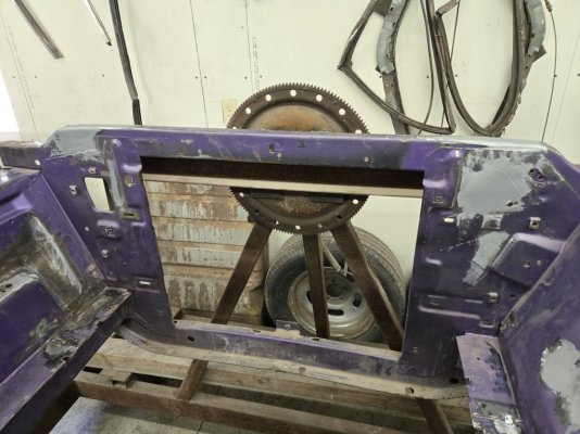

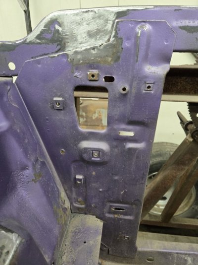

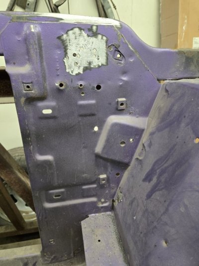

Hoping for a better color match from Revolt Paint, while I'm waiting work continues on the engine bay area welding up cut outs and holes drilled bt previous owner(s).

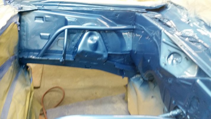

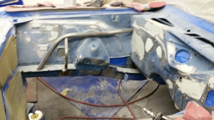

It is a lot of work but the end is worth it I hope. I am still working on mine every single day. I have the wheel tubs welded in and need to finish off the welds. I tried sealer but is does not finish right so I am going to use a little bit of bondo to cover up my less than professional welding. I also relocated the rear springs and patched up the rusted part of the right frame rail with steel plates. I know it is overkill, but I want to race it down the line. Stay positive!

I reccomend using fiberglass or metal reinforced filler over ay seams or welds, All Metal or any parts store equivalent with aluminum added from Advance, Auto Zone etc. ae what I prefer.

I use it on any joints and over welded areas to seal up any possible pinholes and also use it as a base layer for areas like roof/quarter seams then finish with regular filler.
