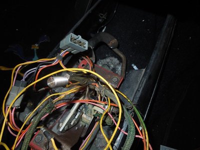

i have ordered two used harnesses from the console over to the rocker and up to the front kick panel area
i must have the wrong harneesss in my console it self because these are not working 9plugging it right)
anyone have a wirung diagram picture s ?? any help

Might have the diagrahm on "pointynosed70wingedvert.net" :jester: What is on your console? Two side lights, maybe a light at the shifter? a lighter? :nachos:

yes three lights
but the used factory wiring i have been getting wont plug into it ????? oh and I would imagine its the same in 69 ? same damn console

Stuie. Mine being a 4spd is 2 wire pink and yellow. Yours would have an orange dash light wire for you girlimatic gear light and possibly a ground for that light probably black, but it seems to me they would have grounded it at the shifter. My diagram doesn't show an automatic like they weren't supposed to exist :jester:

i am now told mine has a 68 harness in the console its self ,
'68 and prior have a 6 prong plug because the back up switch is mounted to the side of the shifter mech. There would be two extra wires coming off that, violet and I believe a violet/white stripe. Starting in '69 there was no backup switch down there. It is incorporated through the newer style 3 prong neutral safety switch, thus a 4 prong connection box at the console.

www.70SUPERBIRDCONVERTIBLES-R-US.COM CAME THROUGH FOR ME :jester: :jester: :jester:
