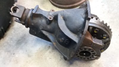

I have one close to home I am looking at. Is their any difference in the dates they where made. Would you be able to tell if it came out of a Dodge or a Plymouth. Dose it make any difference if it came out of a truck or car. Just asking. Want to get it rite. I was stuck with what came in the car. Don't believe it came in the runner when it was built. Due to it had an automatic transmission in it and it was a four speed car.

All 69 RR came with a 489 case unless you have the 6 bbl, or those funny holes in your valve covers. Then you got the Dana. All components for a 489 sure grip 8.75 are available.

Well I watched the or should I say read the article on the clunk problem and all the rest. I was raised by a mechanic in his own rite. His father was a mechanic had his own shop in the depression. Worked on Model A and T's. He showed his son's the in's and out's. My father had a well drilling company and his cousin and he had a machine shop. They rebuilt diesel motor's and gas motor's. Line bored. Put sleeves in the block's. Shaved the block's. Had crank lathes. All types of work on that part of vehicle's. I was their every after noon from school and on the week end's. We never have called a mechanic out to work on our machinery. Like most guy's I have learned by trial and error. Also what I had learned working on my own vehicles. So all in all I should have loaded the axel drive gear's then tried to turn the input on the pinion. After lookin at the spider gear's and axle drive gears seeing no apparent damage to them and with out specks for them figured they where with in tolerance. But so have it they where not so hence you have the clunk. Just to much slack between the gear's. Now I could fix it but you can't get the part for them any more so it is trash. They could be welded up and ground to speck's to get the proper spacing but it is not worth that kind of work. When Racing my buddy and I tore every thing up that you could. Broke pinons off. Broke and twisted drive shaft's. Shattered clutches. Broke 8 blot main's. Twisted axels into. Destroyed bearing's. Destroyed motor's. What can I say. Experience is the best teacher. Book's can only teach you so much. I was told that experience is the best teacher. I have grease and beat up hands from working on car's-truck's and motor cycles. A long with all type's of machinery. So in the end the old story never assume any thing it will bite you in the ASS. Ok enough this novel wont be published. And an Old dog is never to old to learn new trick's. :lol: Russ.

Bob I have the manual four speed going into the car that is what it came with from the factory. Some one had put this running gear in the car at some latter time. When moving it into the barn I put it into drive and it went clunk. Yes the pinion and ring gear where worn real bad. Looked like butter knives in stead of a gear.

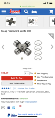

You will most likely have to change the drive shaft when changing from 741 to 489. Most 741 use the smaller u joint and the 489 uses the larger one. I have heard of a 2 size u joint but I have no experience with them.

Hi Fred, you may have to change the universal joint. As droptop said, it depends if that 489 uses the larger u joint. They do make the 2 sized u joint to make it easy and you dont have to use a different driveshaft then.

So it looks like every one else missed saying the 489 has a bigger pinion shaft than the 741 so you need a new yoke on the differential. They make like drop top say's a staggered U joint so you can match to your drive shaft. If needed you can go to a drive shaft shop and have that end changed so you can use the same size bearing through out. That is a better idea but the front bearing will still be small. At some point or another once I do put the 489 in my car will change from transmission to differential all the bearing's to the same size. Doctor Diff. Has a lot of the part's. Good luck my friend. Russ.
