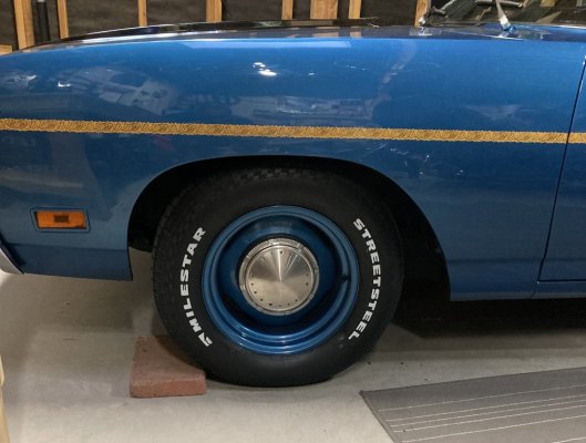

Pulled the trigger today on a set of Milestar (street steel) 245-60-15’s. Just wanted a good looking tire that wasn’t a Cooper or a BFG-t/a. The price and balance and svc. out the door could not be beat! Get this, I left the shop and drove down the road at 35-40 mph with all the expansion joints and tar seals and I could hear and feel it all….tires or suspension inspection…Here we go!

Hey Russ! Morning from the HOT desert! I am taking a close look at the front end components which most have been replaced,however things like ball joints and their lubrication are going to be looked at.Shocks are fairly inexpensive compared to other parts so that has joined the list of scrutiny.
Now the fender rub thing I believe may be a couple of things. 1.If fenders were hung just a tad too far rearward,but all body gaps are excellent. 2. There is a tweak in the right side suspension. The 235-70-15 tires from the front are no longer we now have 245-60-15 which according to specs are not as large (diameter). So that might bail me out. Yes these are heavy big cars and unless you go in and gut the interior and lay down floor,door,firewall,and trunk insulation you are going to hear it all…I’ll be working on a solution…I’ll keep ya’ll in the loop.

The front tire look's like the right size now. Could check to see if your height from the ground to the center of fender opening is the right height. That is in the service manual here on the sight. Like the raised white lettering on those tires. Yes I put insulation on the floor in the roof also. Used X matt from east wood. Lot less expensive than other company's and still is rated the same. The roof is a different type still X matt but for the hotter area. It has a aluminum sheet and cant see it through my head liner or if you do it is not that noticeable. Ran the floor from fire wall seam to the back seat pan. Did not go up to the package tray. After time you will get use to what you here in these older vehicles. LOL. Take care and safe driving.
