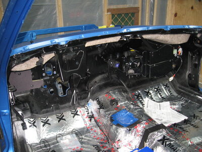

Their is a block off plate for that fresh air vent where the a/c is mounted. Have to drill some hole's in the fire wall as per direction's. Went in easy. Made a bracket to hold the box up on the right side instead of drilling or putting a screw in the lower cowl. Hope you can make it out in the picture. IMG_0105.JPG
