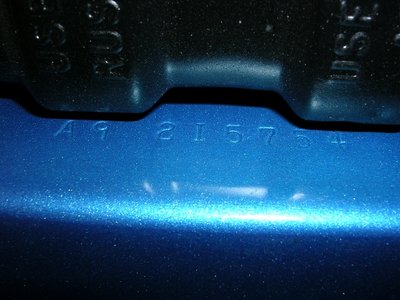

Also check for the VIN stamped on the transmission and right side of the block just above the oil pan. Also a partial VIN stamped on the left upper radiator support and if you want to go to the trouble under the trunk weather strip, left side quarter panel about a foot from the front.
