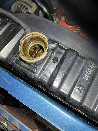

Here in southern Arizona it is finally beginning to cool down mid 80's..AHHH! I believe that burp from the radiator yesterday was a big air bubble and so i refilled what was lost and went for a stop and go drive and got to my first stop in town and gauge said 180 ish and then the gauge just started moving around going upward in temps. t could not decide where it wanted to be. Pulled in the garage and while running put the laser light on the sending unit and the top hose fitting of the water pump and looked at the gauge. What did i see you ask...3 different readings: 1. the gauge-230* 2.Sending unit-180* 3. upper hose fitting on water pump-190*
I may do the rval of the radiator and give it an upside down internal soak and see what i see.

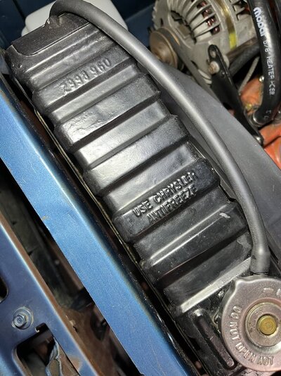

This may be an original radiator with all the factory stamping,but either way at 50+yrs of service it might be time for retirement,but I will see if I can get a little more life out of it…wish me

Don't know about your area but radiator shops are getting to be the thing of the past around my area. They just slap some kind of plastic one in the new cars these days. LOL. Asked around and was told that the chemicals to do radiators was so costly to get rid of is why they are not around now days. Bought a 26-inch three core off E bay. So that is what was in my car due to someone had put a 727 automatic in a four-speed car. It overshot the holes on the radiator support but found out what they did. Drilled some more holes to mount the larger one. Glad I bought a new one. After all they get tired also. Metal brakes down over years of use. :beep:

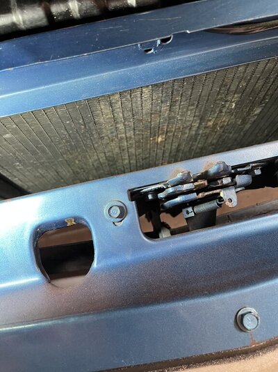

There are some shops around town that will take them and put them in a bath for a soak and then if needed can rod it.
But I will take temps at inlet and outlet to see if there is a radical difference. I could take it and sorta flush it myself,don’t really want to use a caustic chemical on the property don’t have a good disposal situation.
I’ve seen on eBay radiators that appear to be spot on replacement radiator for the 70 RR. They are stated to be all aluminum and that 2-core cool better than 3 or 4 core due to the cores in the 2-core being larger and able to dissipate heat better,don’t know about that!
These motors do run hot and don’t like to sit in traffic…just trying to get the cooling as good as possible. I guess if you look at it one way: Better to get the cooling under control than a possible head gasket blow…which can get expensive compared to a radiator replacement.
