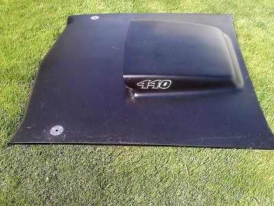

guy on the 'parts has what he says is an AAR hood, bolt on. He is asking $350, and he's only a couple hours away. first thing I noticed is the body lines are missing in front of the scoop. second I think the hood pin holes are too far back. Doesn't look like an AAR hood to me. thoughts?

thanks Steve, that's what I thought. on the AAR site, the pic of the undernreath clearly shows the AAR mark like I've been told.just as well, the Hagerty renewal is due ans strange enough, it;s the same price as the hood...

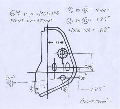

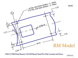

Dave these pics are from the LOH site. My pins are a little farther back also. The body shop removed one of the bolts that fasten to the radiator support and substituted the pin. Hope these help.
Maybe it is just an optical illusion but it looks like the scoop starts closer to the back of the hood. My scoop starts at about 3.5" from the back. It must have bracing for hinges due to the lack of rear pins. Looking at the Unlimited Products website their hood looks like it does not have the bodylines. http://up22.com/road68.htm#PL-114 I would ask for a few more pictures and some more info Dave.
now he "thinks" it's an AAR from '95. Even if it is, with the missing body lines, i'm gonna pass. and he did have it bolted on. just doesn't look right. I'll hold out for an AAR.
