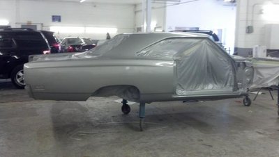

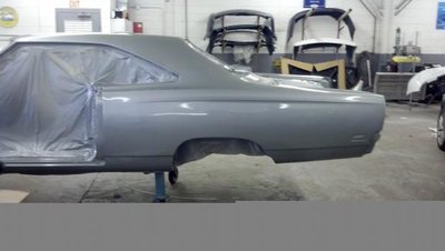

Fresh paint!
IMG_20130906_110939_131.jpgIMG_20130906_110418_167.jpgThe rest of the body parts were painted off the car. It should be wetsanded, buffed and assembled this week!
