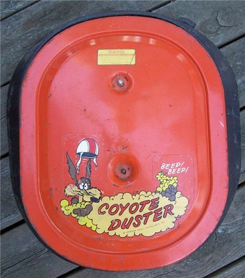

Since I have a 383 car, it came with the standard air grabber hood with the two air intake vents. There is no actual air grabber set up, however, and the vents are closed with metal panels. So the grabbers are only for looks. I have no idea why this is other than possible cheapskateness :bs: on behalf of the first owner of the car when he bought it. Well, I want a functional air grabber system... Is this something that is reproduced these days? Taking it one step further, is it possible to use an A12 style hood with the scoop on it with a 383 car? :huh: I think the air scoop is one of the coolest features of the A12 cars. It gives it a meaner, more aggressive look in my opinion. Not to mention, it would lighten up the car to swap out that old iron hood, I should think. Is this doable or does that A12 air scoop only work with the 6bbl air cleaner set up? The reason I am asking this is because I have seen advertisements for 6bbl intake manifolds for Chrysler 383s. I won't be doing this, of course, but it got me wondering about the A12 hood.

There are more and more reproduction parts hitting the market for the '69 air grabber system everyday. AMD is making the scoops, BE/A just released the screens and retainers, the air duck is available, the air cleaner is available, etc..... Do a goggle search for '69 air grabber and you will be amazed at what is out there now a days.

Great idea, as I too love the Air Grabber set up! The A12 hood will fit perfectly for you. The 68's had a tiny amount of differences in the core support area, so I gotta drill for the pins just a tad different. It's really up to you as far as what you want. On a 68 hood, the vents aren't open, so to install that stuff it would've made more work. That's why I decided to go the A12 look-alike route. Well, that and I think it looks bad ass! The A12 hood will work no matter what you do, and it sure does push a ton of air straight in. One small thing though, to use the correct Air Grabber air cleaner set up, you need a 3 speed wiper system. It's no biggie, just something to remember. I originally had a regular air cleaner on my 383, but once I got the wiper stuff switched over, I put on my AG oval stuff. I gotta say the AG stuff looks better. I love looking into the scoop and seeing nothing but air cleaner!

The A12 air cleaner seals to the hood, so you may have to fabricate something if you want your's to seal too.

There's a guy on ebay who sells the duct work if you decide to go that route. I think it's like $575. You can buy repopped fiberglass air cleaners for as little as $200, expect at least $350 for a decent original that'll need to be restored, or $500 for a really nice metal repop ready to bolt in.
As said before, to use the big air cleaner you'll also need a three speed wiper motor, a three speed switch, and the little cam that comes off the motor.
