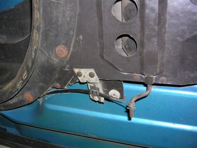

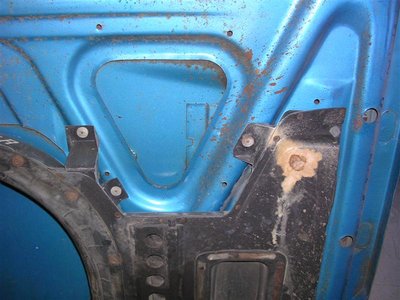

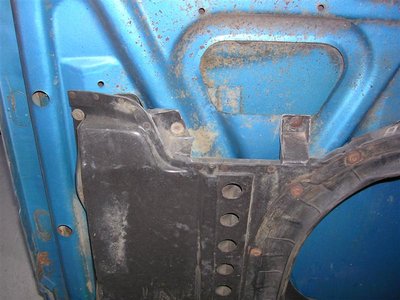

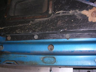

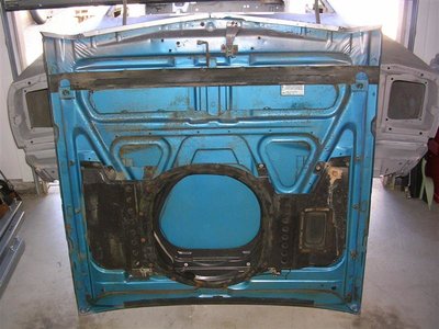

Has anyone seen a Air Grabber Tech article with lots of good pictures in the past? I bought the repop air grabber stuff and would like to see close up details so I know I am installing it all correctly. I have found a lot of pictures of it online but nothing really detailed. :beep:
22,148
2,358

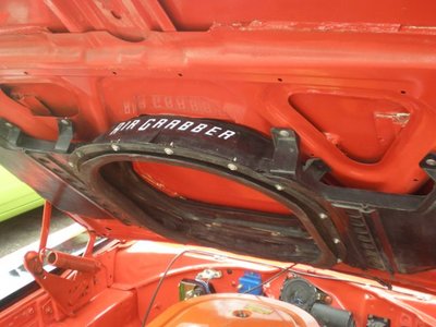

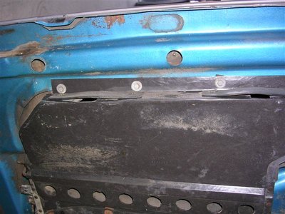

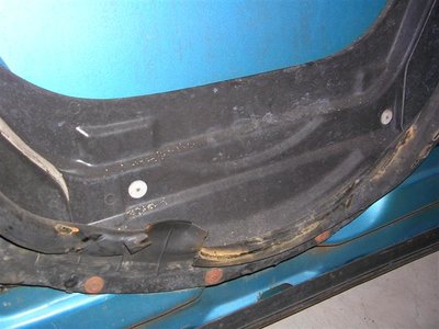

I might have a picture :basketcase: There is a circle of foam rubber that goes on top that seals it to the hood, a 3/4"X3/4" self stick weather strip from a hardware store will do the trick. Take a close look as to what is riveted and screwed.

Thanks that helps. The kit I bought came with outer plenums and the upper center section. It has a cable and 4 smaller rubber seals. No diagrams or instructions. I am sure I would figure it all out but seeing is a whole lot easier. I guess I still need a lower center section with the rubber seal to fit to the breather. I found one online for $100 range. Its a cool set up but expensive for no more than you get. You would think somebody would just offer a complete kit with it all ready to install and some diagrams.

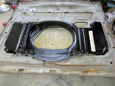

This is all I got from PG classics. Arrived quick, but doesn't have the seat area. I have to buy that elsewhere. Already ordered the breather for a 440 Air Grabber. Should be here soon.
