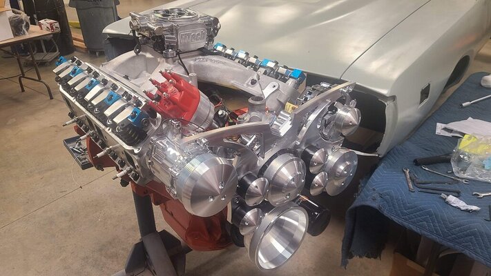

the heat is the problem if the ecu is in the unit bolted to the intake will over heat the ecu . if you use a 1/4 wood/fiber spacer it will help with heat soke.

OK now you have my attention, i was aware of the sensitivity of the wire harness and ecu, but no one ever discussed a solution. What your saying is once i slam the hood shut and step into the real environment it will face, it's going to get very warm there. Thank you for the info.

that fiteck is or might be a problem.
If you are talking about hood clearance for the FiTech with an air grabber, it will not be an issue. But the single plane hi rise intake is another can of worms altogether. No way that will work with a factory air grabber.

I run a Holley Sniper on my 440 Valiant down in the desert in high heat with no issues same design more or less as the Fitech. I have read about some issues with the Fitech so I went Holley. Come to think about it I am useing an aluminum manifold but still 225 degrees at times.
