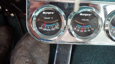

This is what I'm talking about. Both fans, electric fuel pump, headlights, brakelights, A/C and stereo all on at idle and we're above 12 volts. Thanks Power Master!!
