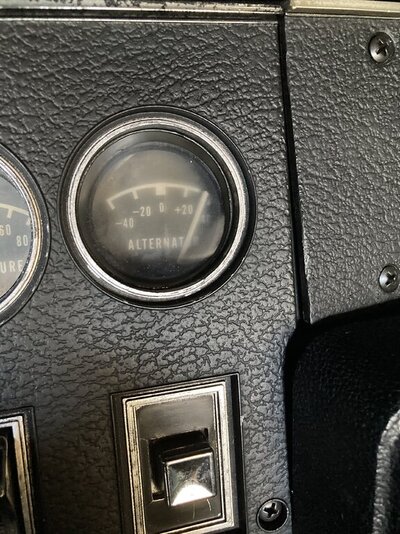

Just went out and fired her up and when i opened the door and sat down as usual to start her with the door open(love that sound)! I always notice the alternator gauge moving +or- and when i shut down the gauge was pegged completly -. Best trouble shooting ideas would be helpful....Thanks in advance!

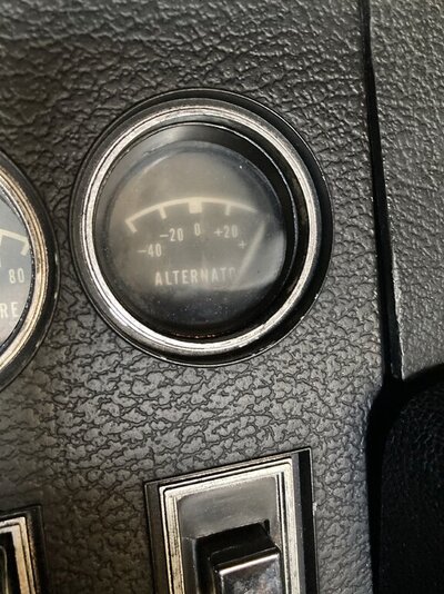

Back on the alternator gauge snafu. As usual I used to notice when I opened the door that the alternator gauge would move to the discharge side. But as I said in the first post it appears all the way pegged to the neg. side and stays there. Yesterday got in and turned the key to ign. and the gauge moved to -40 then turnoff and back on and it bounced back there again and start and run and nothing. Help! Sounds like a ghost in my cluster.

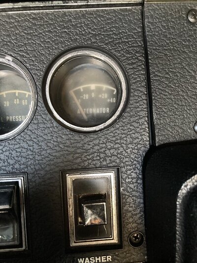

Thanks to you all for the info. I will check all of that stuff. The pics show the gauge needle pegged full negative whether running or not. I know that I have some protection from it burning if that were to happen 1.Fuseable link

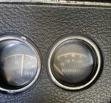

Hence a real good reason to pull it all out. Here’s maybe something of interest,started her up and the gauge pegged all the way to +side and stayed there bouncing a little when I applied the brake. Shut down and it stayed pegged + until I applied the brake pedal and then back to all- side

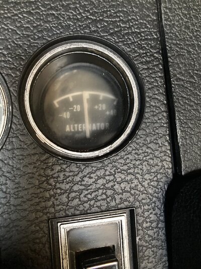

Went through the process again and now as you can see the needle is neutral as it used to be before all this started.
